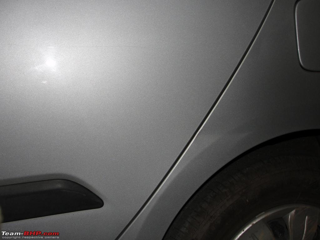

Thinkbig - Tried out your solution & was amazed at the results Thank you so much !!
Check out the pics of the before & after. Its almost nothing ever happened.
Just a light wipe & the marks flew away !
Thanks guys for all your suggestions & time taken to reply, really appreciate it. I have learnt much from this forum & remain forever grateful for all your caring & sharing.
Just the other day, i added vinegar to my detailing kit & now Isopropyl alcohol swabs too.

Wow!! the mark is gone! I have a few on our white esteem. Your results are motivating
What are these swabs? Where did you get them? Can you put some light / post some pics?

I got a ready to use packed swab dipped in alcohol. Used up 5 of them to get this cleared. (Rs. 2 each X 5 = total Rs 10)
Sorry could not take pics, got them from the neighbourhood chemist shop. Am picking up some more tomorrow for my kit. Google it, you will get the idea of the pictures !
