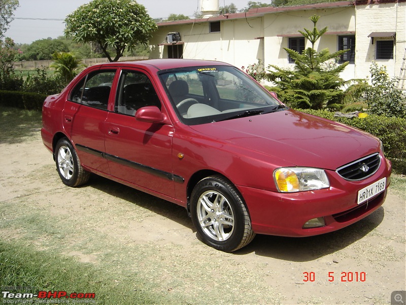

With the Arrival of the hawk,my Reliable workhorse was being neglected,and it was under a Cover of dust,owing to recent storms.
Spent 3 hours in detailing today.
Equipment used.
3 buckets of water.
Formula 1 Wax
F1 Tyre Foam
Waxpol Vinyl Polish
1L of my sweat

Great results paaji , but dont use Formula 1 Wax too frequently because it contains polishes , use turtle wax insted. And BTW , you have used too much of wax !!!
I dont use it often(Like once in 2-3 months),and i have been using it since years on various vehicles,never had any complaints.
Wax looks too much due to the Color.
Only grudge i have is that it remains visible in nooks and corners of dark vehicles after wiping off

Really nice results Akshay!
do get a sealant and then layer the sealant layer with formula1 wax that you have! You'll be surprised!
btw I like the alloys!!

Good work. But tons of polish buddy!!! Actually after rubbing in the polish you should be able to see only a light haze. Most of the waxes (unless specifically mentioned as "Pure") have abrasive cleaning agents. As you rub...rub...rub (few more liters of sweat!!) the polish gets broken down and the abrasives clean your paint - that's when the shine comes through. If the polish is smeared and then allowed to haze before you buff it away you are not doing justice to your sweetheart.
Next time start in the morning - use less polish and work it to a almost invisible haze, buff it off - have a shower and lunch - come back and apply an even thinner coat of of the wax and wipe it down lightly before it dries.
Don't forget to send me a thank you note in the evening !!!
