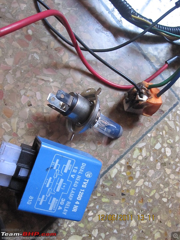

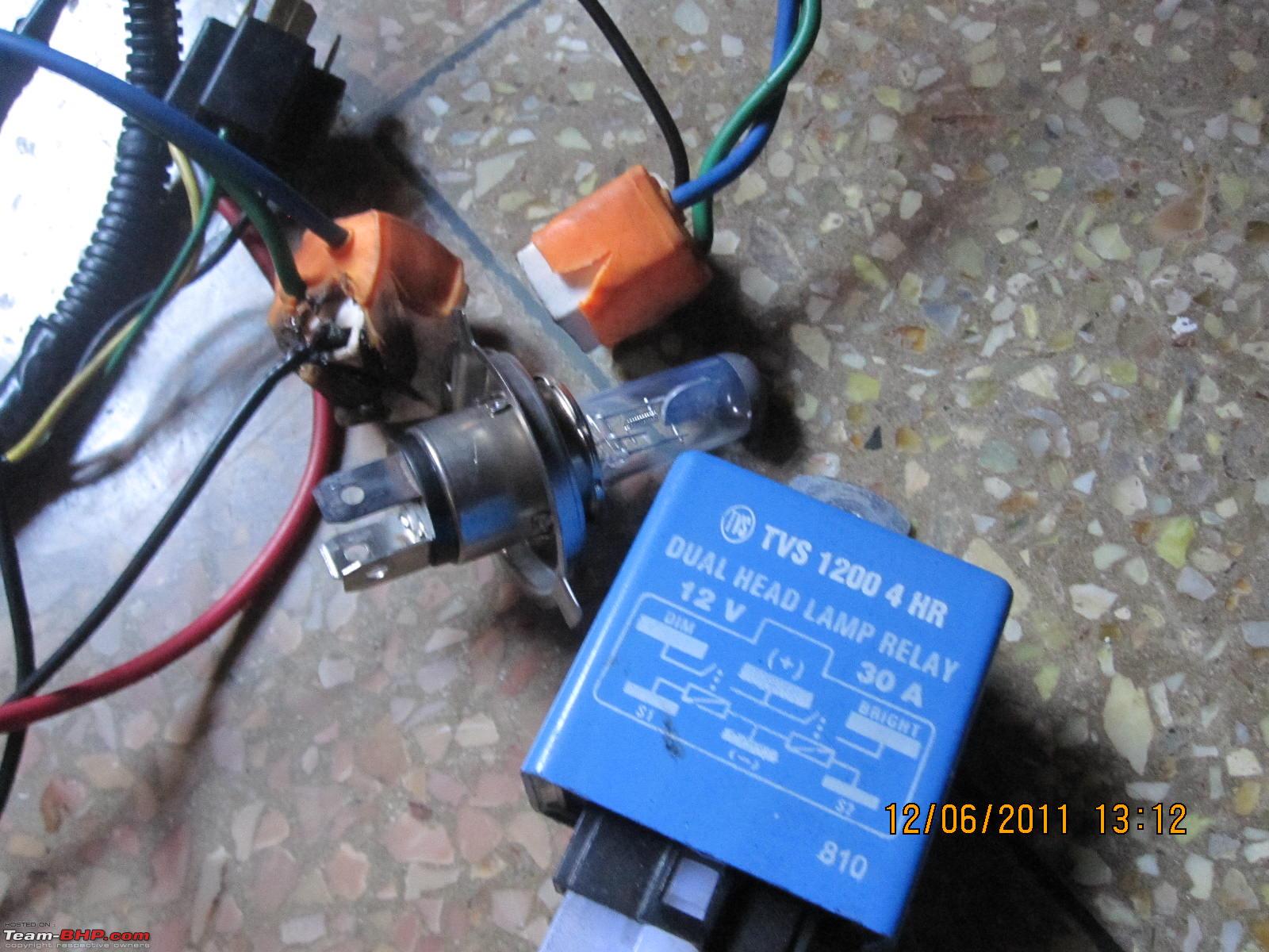

I removed the relay and found that the holder wire is also melted and The lamp leg is blackened on RHS.
Any one have any idea about this .

It appears that the bulb was not secured properly into its socket. This has caused arcing leading to the blow out!
BTW, is 90/100 not sufficient lighting?

I checked when removed all the legs were inside the holder.
Even 100/130 wasn't adequate , the culprit might be headlamp design dont know.Now in a soup.
100/130 should be way more than adequate (rally lighting!). Did you upgrade the wire harness as well? From the pics it looks like you did not (could be wrong). It is possible that you did not upgrade to the correct guage. Also, resistance of the circuit increases with a higher watt bulb.

You are lucky that your car did not catch fire due to a short circuit. I suggest you go for HID/ Xenons instead. Safer if you want a lot of light or just add a couple of Hella FF55.

Is the relay even rated for 130W power?
I don't see any marking on the cover.

I was told by the installer that the relay is for 100/130 and is a plug and play , no need to change anything else. One end of the relay was plugged to the stock output holder and i believe the extra power was drawn directly from the battery as the relay had input from the battery.
The same setup is running on my friends bolero without any issues for more that a year or so. He recommended me the installer.
Infact the bulb had more illumination than the stocks,but not adequate for night driving at least for me which i suspect might be of the dome design or may be the windshield film is blinding.
Now that the top part of the dome is melted, I need to change both the headlamps,Not sure whether the dome itself will be available or not.
Your holder was just a standard one which cant take the heat of even 90/100 and its got melted and there by it started loosing its contacts gradually and started arcing in the bulb pins. Now you can do the math
Due, you have missed one important thing before going for a major bulb upgrade: A good wiring harness with Ceramic Holders which is must even for 90/100 as it produces lot of heat which can't be supported by a standard holder as on long drives it produces good amount of heat and that's a rule of thumb in bulb upgrade. And this is why I commented about your installers capability. Stay away from these morons and go to any other reputed installers to set it right.

Its is almost next to impossible to drive around at night with stock headlamps on kerala roads except cities. Even coming back from work at night was worse.
Basically I wanted to go for 90/100 with relay, But somehow my installer convinced me that the reflector can take 130.The relay holder is of ceramic type and the total setup cost me around 2k including bulbs (philips Rally 200 each).
