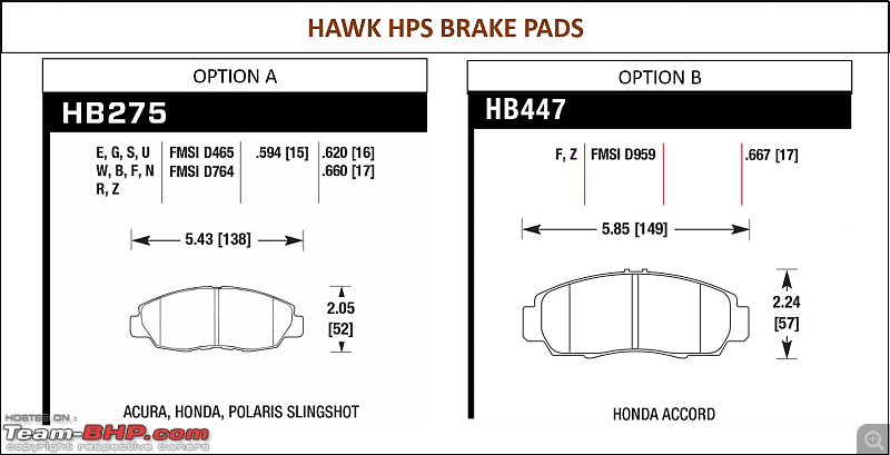

Hello all,
Below are the two models of Hawk HPS brake pads for the civic. Can someone help me with picking up the right model from the two options that can fit my 2008 Civic.I assume it should be option B- HB447. Appreciate your help on this.
Option A- Hawk HPS HB275
Option B – Hawk HPS HB447
Honda Civic : Maintenance, Service Costs and Must dos-brake-pad-comparison.png
Thanks in advance.

Old 3rd August 2018, 20:48   #9157
laluks's Avatar
Join Date: Sep 2008
Posts: 6,552
Thanked: 16,442 Times
From the shapes, small one looks like for the rear and big one for the front
laluks is offline   (1) Thanks

Re: Honda Civic : Maintenance, Service Costs and Must dos
Originally Posted by Aslamjaffer View Post
Hello all,
Your best bet would be to check with the seller of these pads.
Assuming your car is a 2008 Civic and you need front brake pads, cross checking at Boodmo for dimensions shows Option A to be the correct size. Boodmo Honda Civic Fr pads
The rear pad dimensions is 88.9 x 47.8 x 14.5 and both Options A and B will be too large for the rear calipers.
Please keep in mind there are variations in models sold in different countries. A Civic sold in the US and NA market may have different brake and other components from a Civic sold in Asia. Go by dimensions OR use a cross reference chart to match OEM part #s to aftermarket part #s.
Laluks is right. The big ones go upfront and the small ones at the rear. I had bought a set of front and rear that I never installed as the SA said the OE ones have more bite left in them than these aftermarket ones.
Also have a set of Brembo pads for the rear that are yet to be put on the car.
