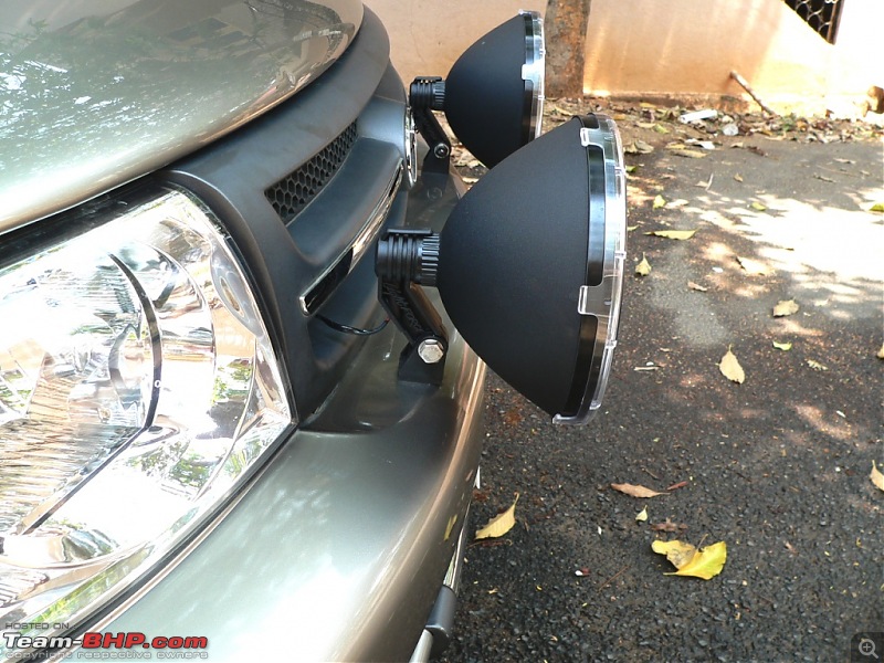

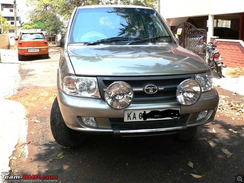

lightforce 240 for my safari
I installed the Lightforce 240 for my safari couple of weeks back. The results are simply amazing. . It simply overshadows the philips extreme i have in my Headlights.
I got it installed at Car fittings , Double road. His name is Basha. You need to take a left turn after HDFC bank when you are heading from Lalbagh towards the Double road flyover. He charged me 1400Rs since I got my own wiring harness. He would charge around 2500 if he has to prepare the wiring harness and the cutout.
I initially thought of getting it installed at Sai colorium but since they were not keen to do it in my presence and insisted on leaving the vehicle, I came across this shop. They did a decent job. Here is the pricing part. Since i got this lights from US, it costed me 239$ for the light and 55$ for the wiring harness. So it was roughly 14k.
Basha was mighty impressed with the harness. I also got got the nuts welded after the installation as a some sort of deterrent to flick easily. I did not go for the installation over the bulbar coz it narrows the spread of the beam since it will be installed close to one another.
