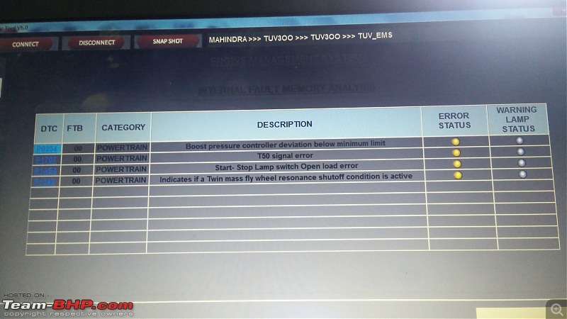

Re: SOS - TUV300 Engine Check light on - Stuck on NH8
This is the diagnosis.
And what is the prognosis now?
They have put this part - cut the pipe and inserted it.
Mahindra TUV300 : Official Review-img20151225wa0015.jpeg
What is it ? Did they explain you why have they done this ? Also, please ask what are those warning in detail if possible.
ntomer, hope your return journey is safe and sound. Could you please pin-point the part/pipe? Though we can see the picture we cannot just make out.

No return journey, I am on my way to Mumbai. Delayed by three hours due to all these chaos. Surat, my stop for tonight is still 80 kms away. Tomorrow, I will go to Udvada, and then Mumbai.
The part they place is that black rubber thingie on the grey pipe. They cut the pipe and put it there. It is some sort of modulator.
I have booked an appointment for service in Mumbai, I will ask for details there.
