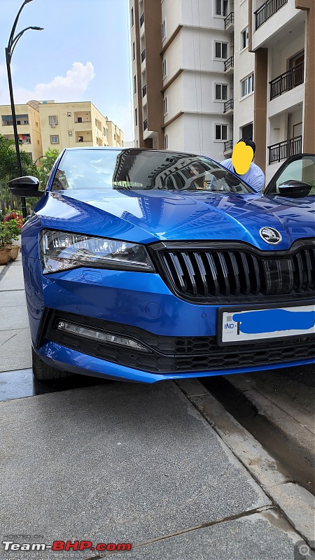

Overall, it's been a wonderful 20 months of ownership. Many long drives, many days spent washing and caring for Nightwing. The car has really impressed me and will always have a place in my heart. My first luxury car, the first European in the family & by far, the longest, widest and roomiest car ever.
The silver lining - the new owner and I got along really well, he's also a petrol head and adores the car that makes the deal so much sweeter! And, he has offered to give me Nightwing anytime I visit Hyderabad to rekindle the romance . Couldn't find a better deal anywhere.
Skoda Superb : Official Review-20220731_110446.jpg
Skoda Superb : Official Review-20220731_110453.jpg
Skoda Superb : Official Review-20220731_110517.jpg
Skoda Superb : Official Review-img20220731wa0015.jpg
Guess it's time to hunt for my new car in USA (and update my handle too )
