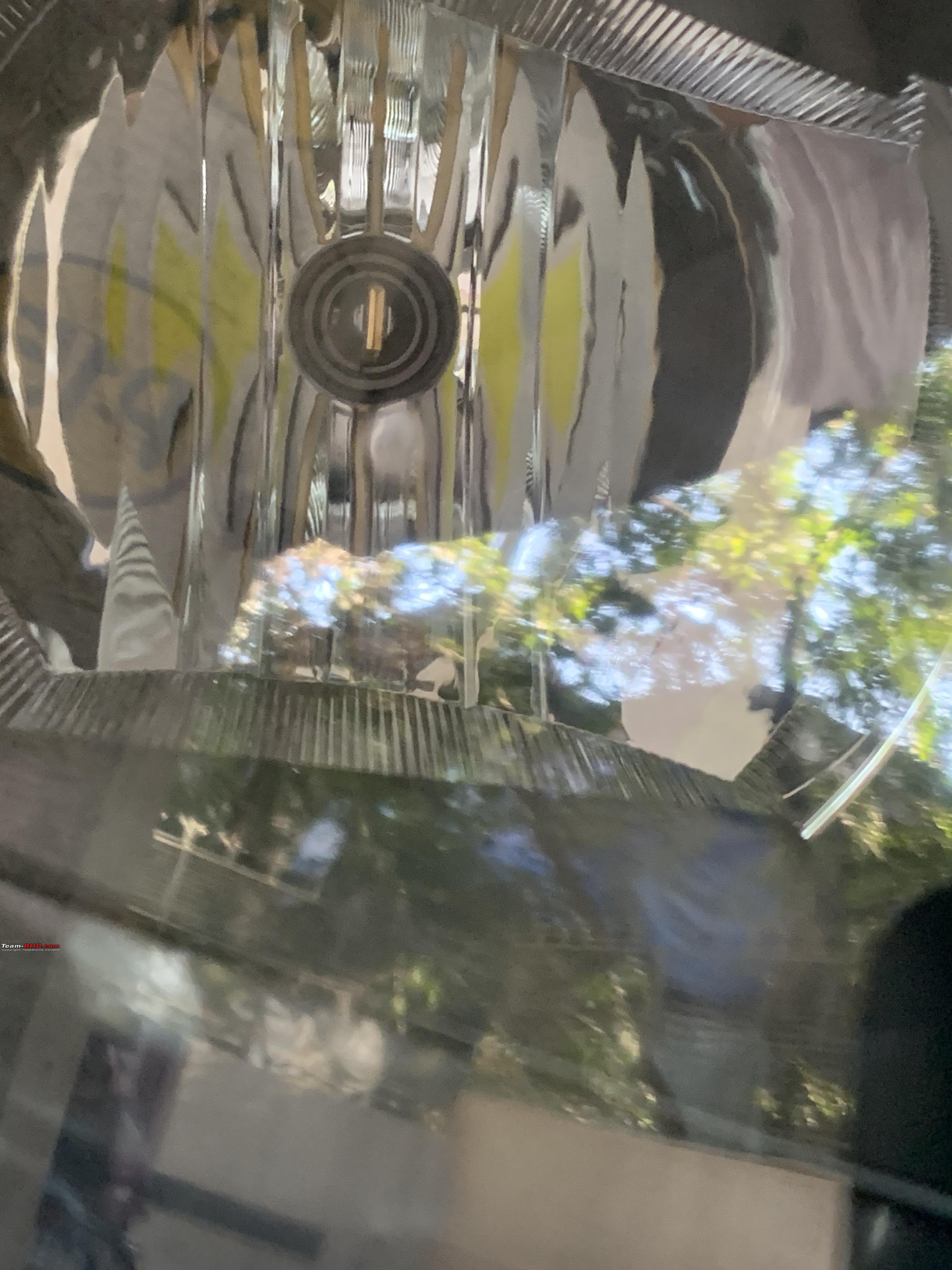

However, the rotation of the bulb must be taken into account since this is very important for a good beam output. I can post a picture of how the bulb must be aligned later today. Basically the bulb has a flat PCB with LEDs on either side. This must be aligned to be vertical so that the LEDs fire sideways on either side of the PCB into the reflector.
I saw your post and ordered and fitted the Osram Leds
Toyota Innova Crysta : Official Review-f0844d6045874498a36da9447cea84d4.jpeg
Toyota Innova Crysta : Official Review-3ca5c12a46b04130b5116c2baf575710.jpeg
Toyota Innova Crysta : Official Review-641f4aab62a1441eaa55a25ed8aa9a12.jpeg

Hope the upgrade is worth it. I see that the bulb is slightly tilted at an angle compared to the reflector so try rotating it in case the current output isn't satisfactory and you can't see a bright Hotspot at the center when facing a wall.
