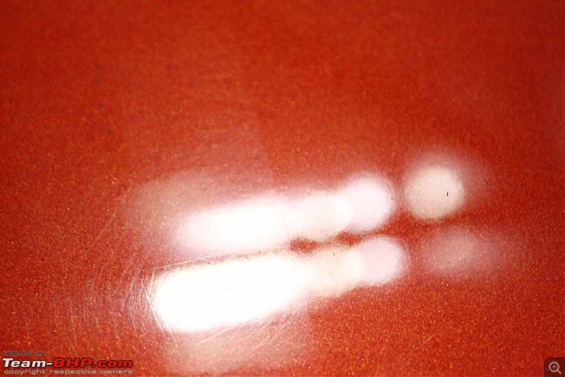

Got a bottle of Meguiar's Ultimate Compound to restore the paint finish on my 4 yr old Swift (Sunlight Copper).
Unfortunately, the paint has a lot of swirl marks and has generally lost its shine.
However, with just 5 mins of rubbing on a small area of the bonnet, the difference is striking! I'd separated the two parts of the bonnet with a tape to make it even more apparent.
No prizes for guess which side of the bonnet in the photo has been treated with ultimate compound
It even gets rid of minor scratches. A truly amazing product! I just wish I had a powered polisher of some sort. Rubbing by hand means that you can only cover one panel at best before your arm goes dead.

Good results d3mon! UC is recommended over Swirl X when working by hand as it has more 'cut', its what Ultimate Detailerz told me and i can see the results you've achieved.
How many times did you have to 'rub' or how many passes did you make for the swirls to disappear ?
Also did you use a Swirl Finder light to capture the difference ?

Wonderful results, much better than what ScratchX2.0 did to my Swift last week.
I agree on using these products with hand, its a pain!

I'd seen a lot of youtube videos before deciding on UC vs SwirlX 2.0.
Meguiar's say that you need to break down UC while rubbing it, so I rubbed for 3-4 mins with moderate pressure on a 1sq ft area (approx) before wiping it off and polishing it slightly with a micro fiber cloth. You need to make sure to wipe it off completely before it dries out.
These results are with just one "pass" of UC
No, this is not a swirl finder light, just the daylight streaming down into the basement from a narrow window in the roof
