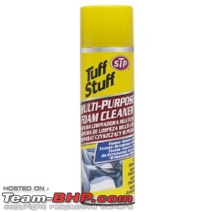

Try This it is locally available
i use it on carper , seats and beige colored lower dash and trims. it works wonders .
  1. Spray foam on areas to be cleaned.
  2. Wait for 20-30 secs.
  3. scrub with soft brush or foam applicator.
  4. clean with micro fibre cloth.
I follow these steps and i am happy.

Ok.. I did a quick search for this. Seems this now comes with Armor All branding. Is it the same as STP manufactured product?
The cost is around Rs. 395 + shipping on ebay.in and Vicky.in.

@ Notorious - STP is looked down upon in the US so please share if the product is good for all surfaces. It certainly looks promising. I was thinking a quick Vaccum and this foam should do it. The floor mats can be washed in conventional manner. I think Sonax has an Interior Cleaning Spray while Meguiar's has some kind of Interior Detailing Wipes.

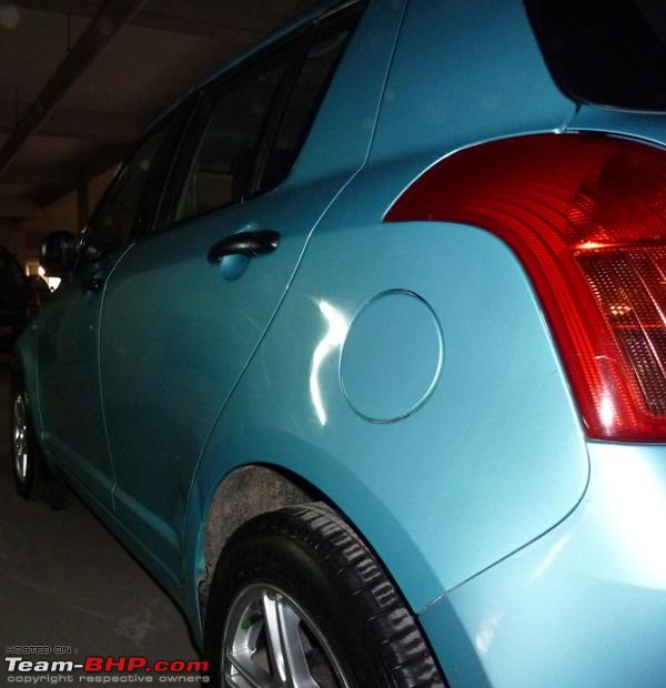

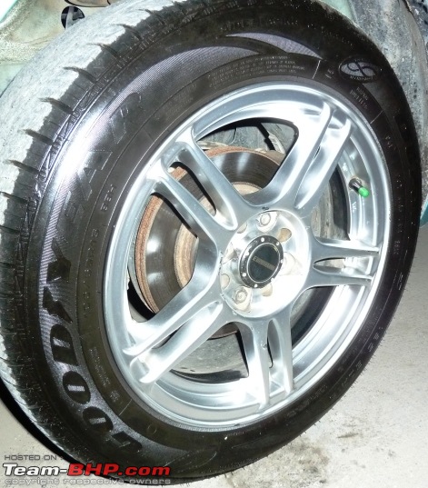

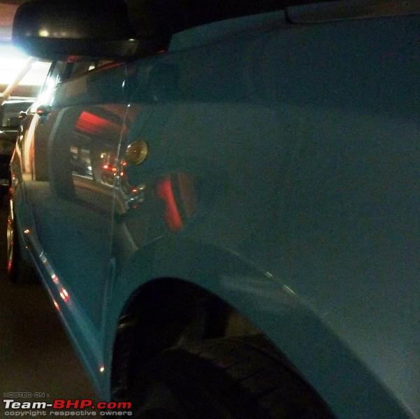

Day 3 of detailing:
Applied 2nd coat of Klasse Sealant Glaze (KSG). The KSG cured for almost a day and man what a shine. I cannot believe that my 5.7 years old car could shine this much. I have decided to have 3 coats of KSG as suggested by some detailing forums with a day's gap in between coats. This helps the sealant to cure (bond) with the paint. I also coated my alloys with Klasse AIO and the results are equally good.
Tomorrow i will do the final coat of KSG and then top it off with Collinite 845. Few pics attached. They dont do justice to the shine the car has now. Since it is raining today, i dont want to take the car outside. Hopefully if it is sunny over the weekend, i would take it out for snaps.
I dont feel like taking it out nowadays, for the simple reason it would get dirty :-(

Day 3 of detailing:
Superb results! The pics don't do any justice thanks to the poor lighting, you can try increasing the exposure and clicking if you're using a P&S, lot of options if you've a DSLR on hand. To an extent,the one pic in B&W gives an idea of what you've achieved
A query, what did you use on the wheels ?Just Hot rims cleaner or did you top it off with something
I agree. I was just standing and appreciating the result. Today being Lakshmi puja lot of gentlemen in our apartment were around when i was oggling at the car. They must have thought i am nuts
I used a Point and Shoot. I will take out my DSLR tomorrow and try to take better pics. My DSLR has been gathering dust and now is a good option to take it out.
I used Klasse AIO in the alloys and only Megs Hot Tire Foam in the tyres.
