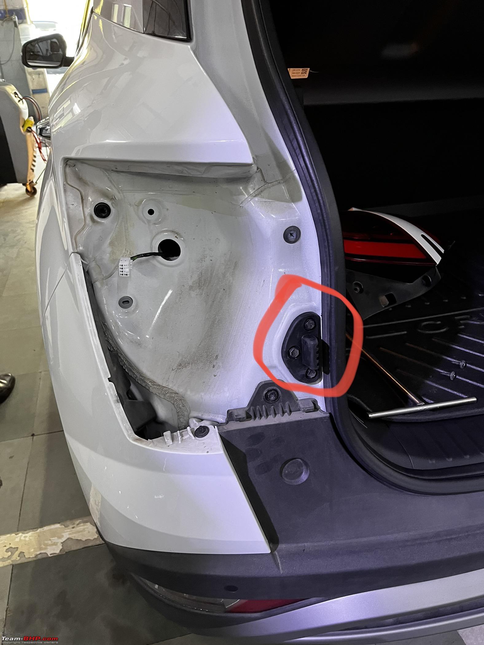

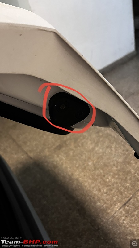

This is definitely a common issue on the new Creta. Another Creta in our family had the same noise. Here’s how we got it fixed:
The pair of rubber on each side of the boot (pictures attached) were changed and it finally solved the noise. Before this a lot of trial and error methods were used by HASS, including applying tape on the metal part which connects with the boot, which did not do any good. Now the ride is almost silent on the uneven roads and minor potholes.
Regarding that highly irritating creaking noise from the center console, which plagues the Creta and Alcazar, we got it reduced to almost 10% by applying some foam on the console internal locks. This has greatly reduced the noise.
Now that's a relief. Thank you for sharing the solution, Sir.
Will try getting these rubbers from the Service folks this weekend.

You’re welcome!
Forgot to mention earlier - You might want to note though that the fix didn’t resolve the issue immediately. I think it took about a week/10 days before the new pair of rubber settled in and started showing positive results. It’s been more than 6 months since then and it’s all good now.
