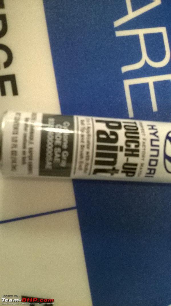

Owning a semi-large sedan in Dark colours & driving around in Bangalore, you just can't escape minor scrapes & scratches. It is so strange that I would have parked my car somewhere in a safe area & after few hours,somehow a scratch would show up! In my driving of 10 years in US, I never ever had a scratch of any sort on my cars. Driving around in Bangalore is insane & my Fluidic Verna has picked minor battle scars.!
Being a little too vain about having minor scratches on my car & that too on a dark colour, I wanted to see what could be done about it. More than the looks, for me, it was the metal being exposed & danger of rust. One thing was to go to the Hyundai bodyshop & get some touch-up paint applied on these minor scratches. But either I wouldn't have time to go or the bodyshop sometimes wouldn't have the colour mixed already.
I remembered that when I was in US, my local Hyundai dealer used to sell Touch-Up paint pens for Hyundai cars. I called them up & enquired them about my specific colour & they had a pen in stock. So, I got it via a friend who was coming from US.
It cost me about $9.16 & is a genuine Hyundai part. It comes with a brush (like those nail polist ones) & also has a Roller Ball applicator tip. For larger areas, you can use the brush but for fine application, you can use the pen which just glides over.
Does it blend well? Well, no. You can always see that it has been brushed over. But at least, I don't have to worry about the metal being exposed etc. Mind you, it's only for those minor scratches. I wish Hyundai sold them here.
I know many here scoff at these types of Jugaad treatments. But it has been a struggle to avoid these minor scratches the 2-wheelers impose on my cars, I had to resort to this :/
