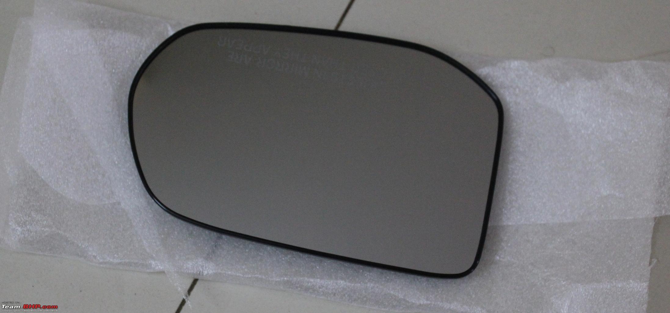

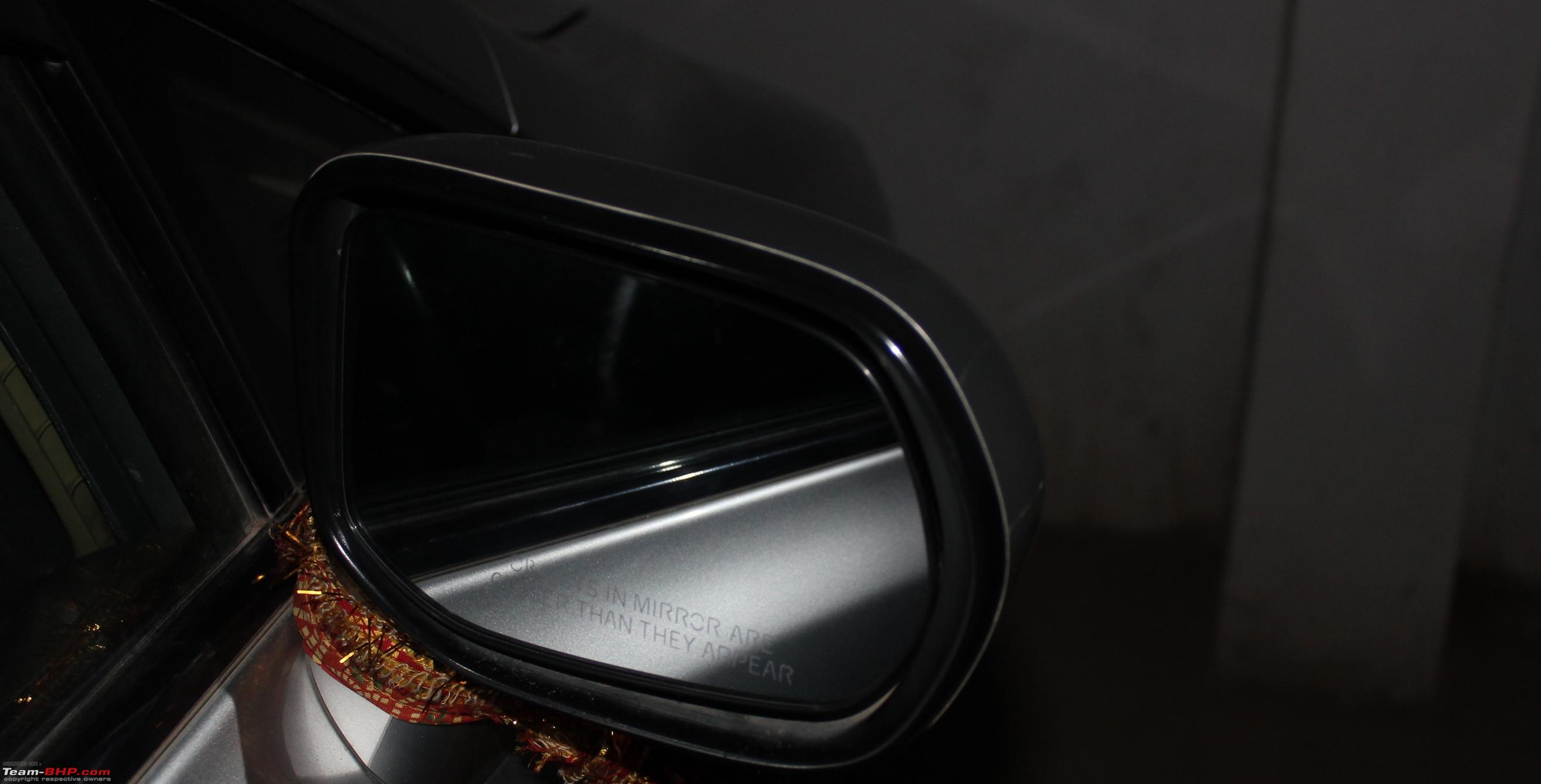

Originally Posted by devsoftech View Post
.. I need help with installing the RHS outside rear view mirror, any pointers will be welcome - need to slip in the glass....
Attachment 1188145
Was able to fix the mirror by myself. Some of you might be knowing that I got a copy of CIVIC service manual. Followed the instructions and replaced. Simplifying the documentation below, pushed the top of the glass inside, slipped a screwdriver from bottom and the glass came off without any issues. While putting new glass, it has a hook which slides in a crevice, and the lower part clicks-in to lock to the assembly. Morever, there is adhesive sticker too at the back of the glass.

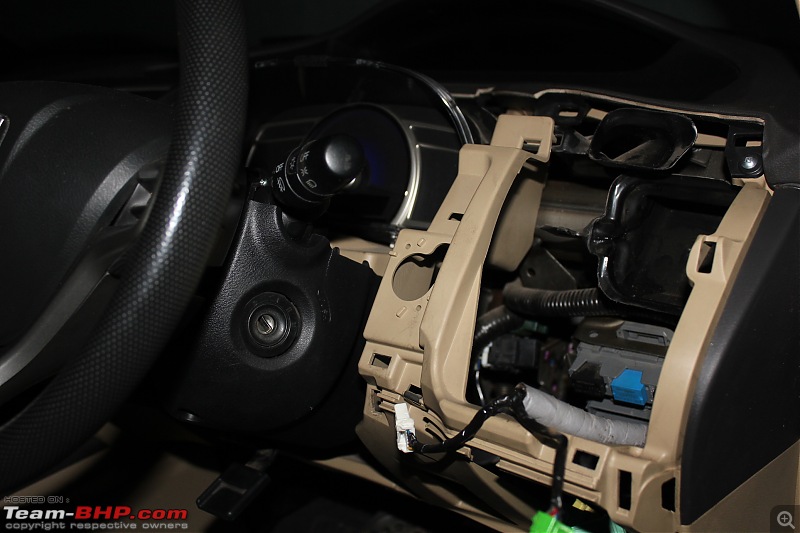

Also, sharing the pics of MICU disintegration. Will have some updates on Saturday now.
From the service manual
Honda Civic : Maintenance, Service Costs and Must dos-mirror_manual.png
"Foreign" Mirror
Honda Civic : Maintenance, Service Costs and Must dos-img_7433_am_mirror.jpg
Dashboard opened for access
Honda Civic : Maintenance, Service Costs and Must dos-img_7435_dashboard_opened.jpg
