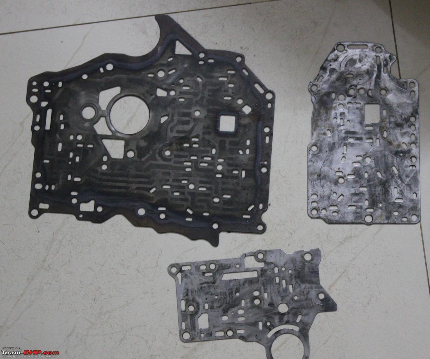

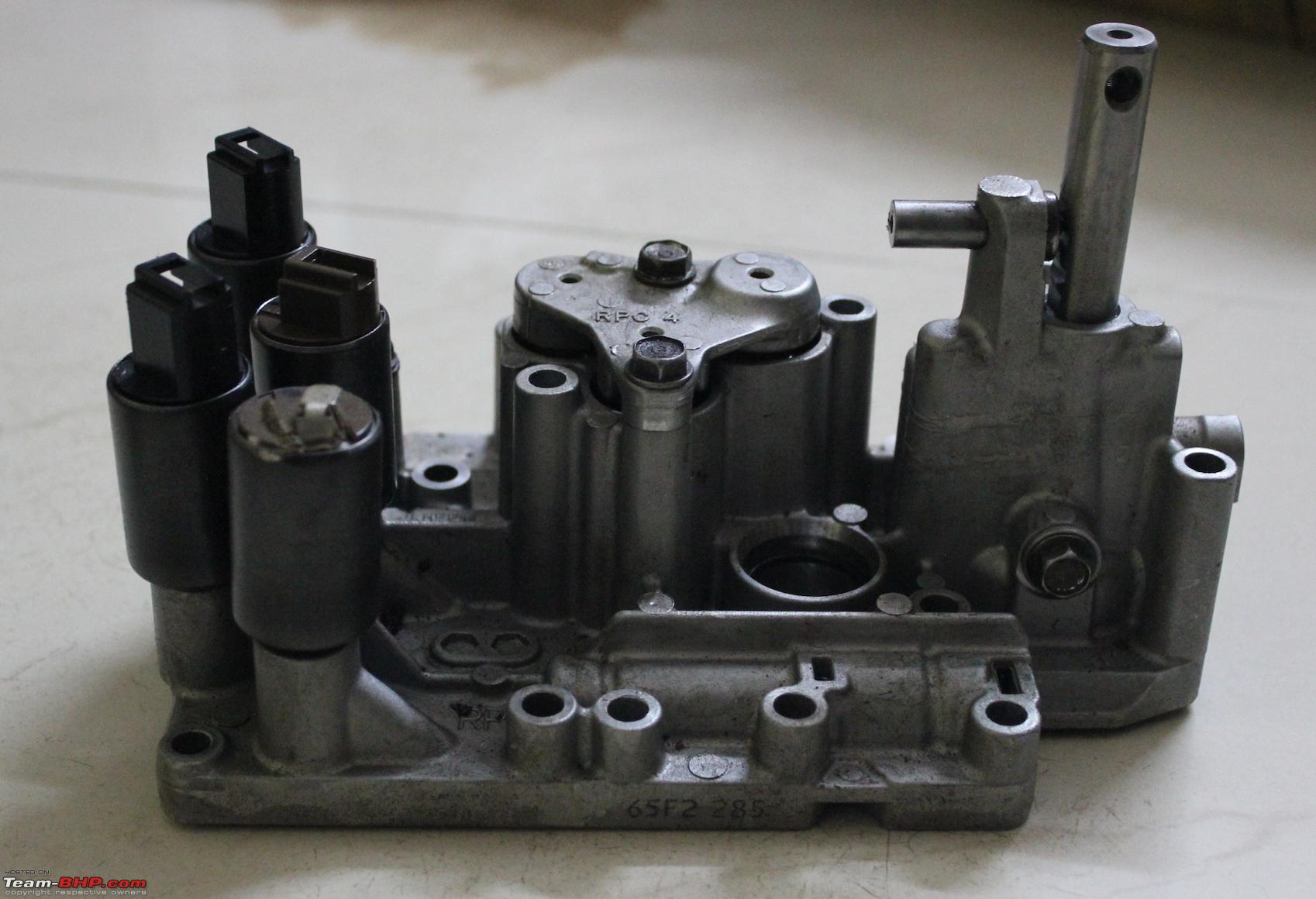

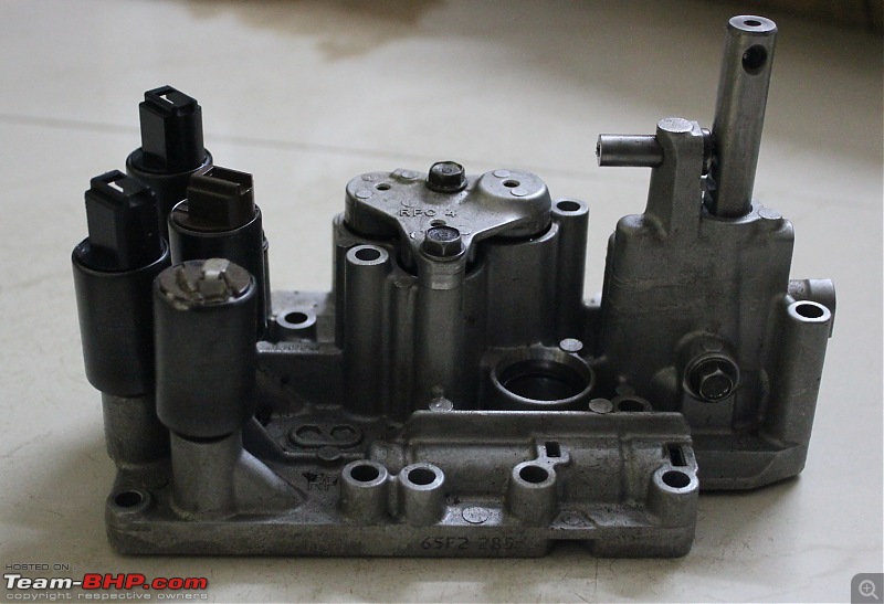

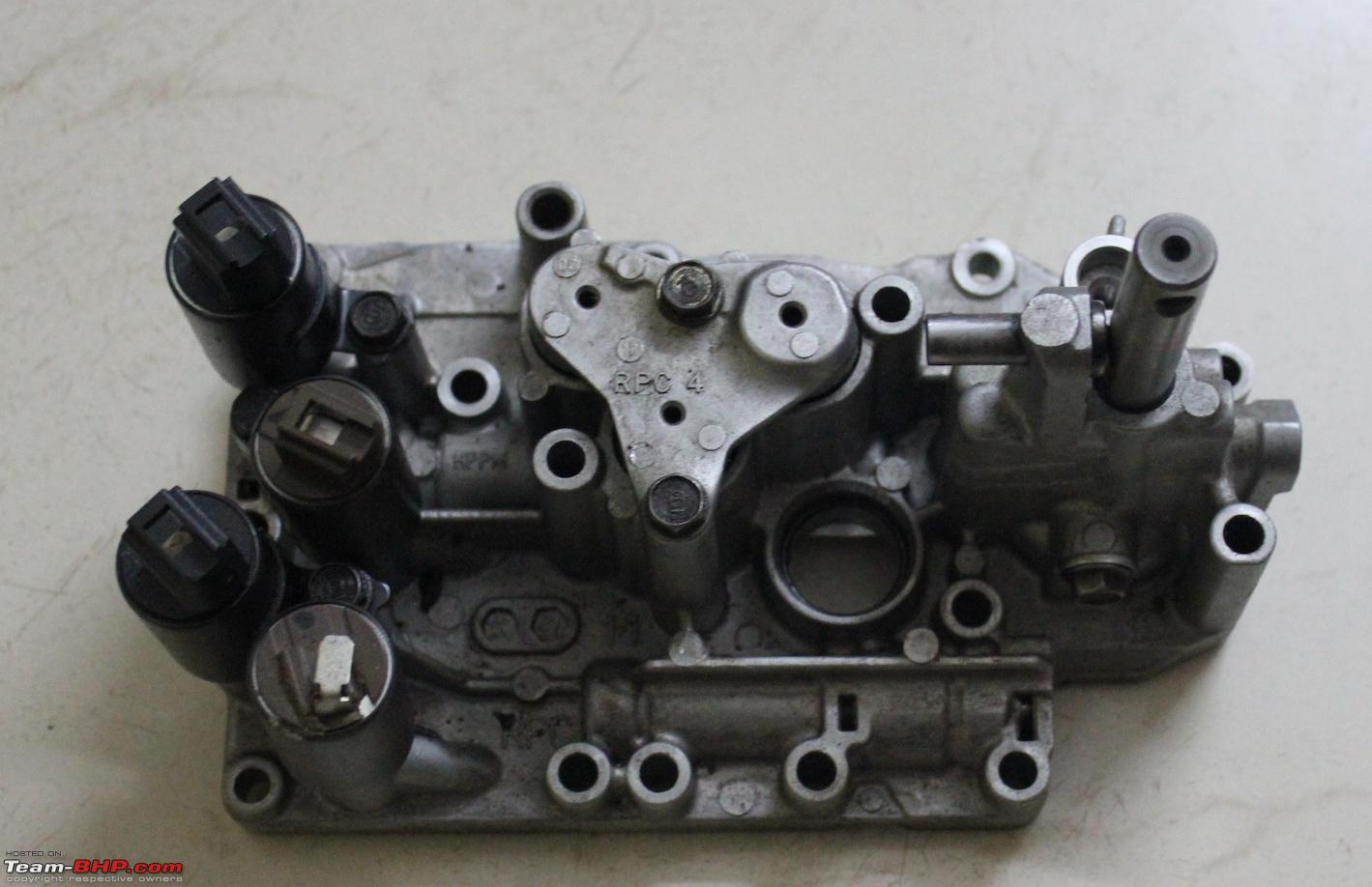

Originally Posted by devsoftech View Post
So, finally the CIVIC comes back to me.
Total Damages: 134585 (32000 was for headlights which was replaced as the previous one was aging - So its close to a lac - including 60K estimate + VAT + labour)
Here's the bill - to fix the 'D' issue (Which my friends have also been waiting for )
The parts took 14 days from Noida/Chennai warehouses, and couple of weeks to fix, test, failure-fix-retest.
I have been patiently following up with the service center, and the area manager appreciated my patience - which he says was instrumental in doing justice to my car to his satisfaction. Close to 100 kms of road testing was carried out. I have reimbursed 500 worth of petrol, for which they provided me fuel bills. Rest was from fuel I had filled previously.
I actually ended up buying a wagon-R till I was CIVIC-less.
Anyways, here's the scanned image of the bills:
Will share pics of the faulty parts in a future post. I'll be compiling that soon.
The parts that have been replaced (Rather what made my AT tranny)

The solenoids
Honda Civic : Maintenance, Service Costs and Must dos-img_7304.jpg

The gaskets
Honda Civic : Maintenance, Service Costs and Must dos-img_7308.jpg
