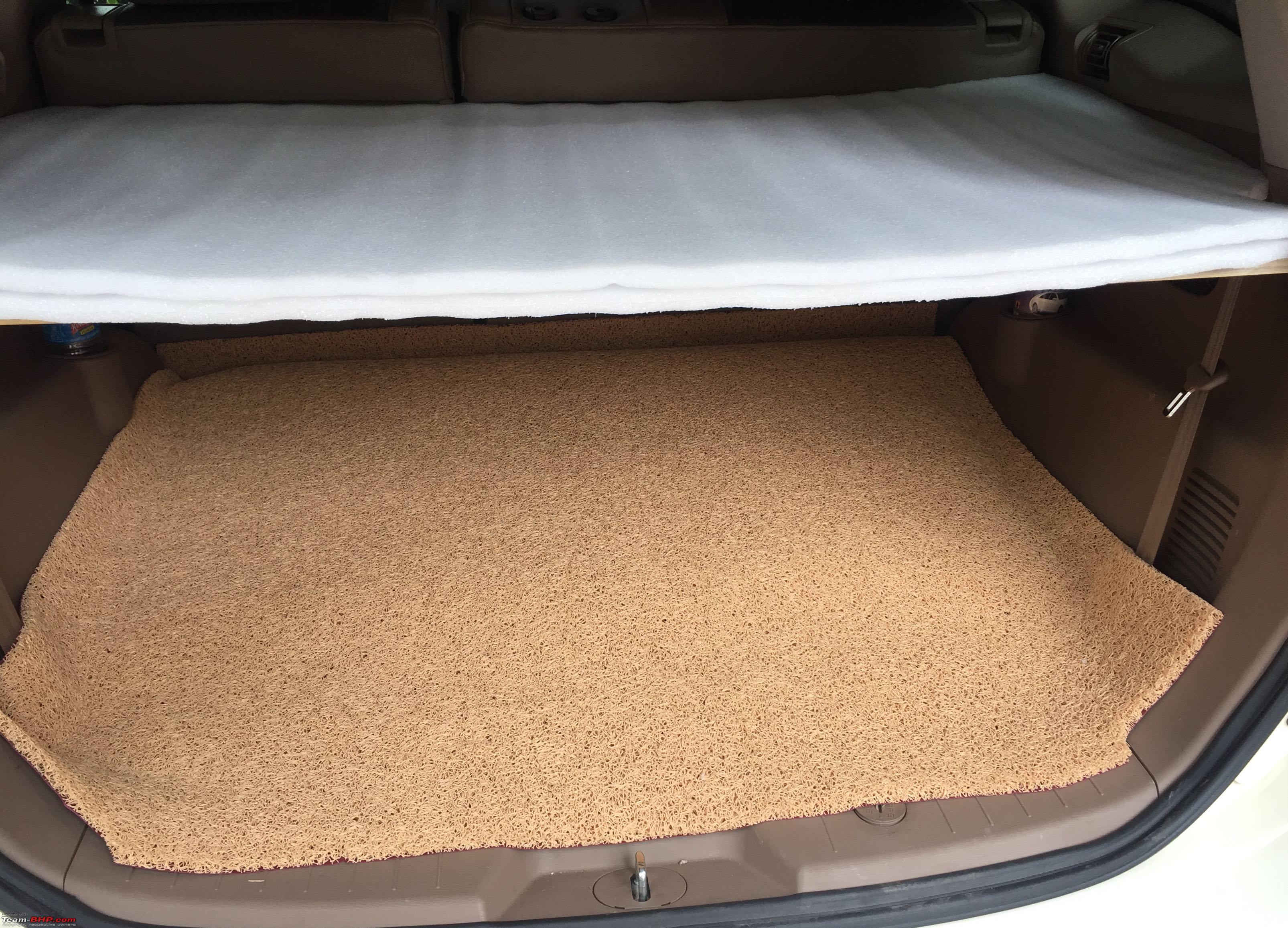

Not exactly a parcel tray, but good enough
The idea was to cover the stuff in the boot to keep the sun away and also prying eyes. Providing some excitement to the overzealous security guards at mall entrances is an added bonus.
Step 1. Fixed wooden rods available from any hardware shop selling wooden beading etc. Cost - Rs 5
Mahindra XUV500 : Test Drive & Review-supporting-rods-2.jpg
Step 2. Cut foam sheet to size and place on top. Purchased a 15mm thick sheet (1400 X 2000mm) for Rs 269. Cut it in half and put two layers of the sheet.
Mahindra XUV500 : Test Drive & Review-finished-look-1-2.jpg
Further suggestions:
1. Use a thicker sheet (30mm) so that it does not sag as shown in the side view.
Mahindra XUV500 : Test Drive & Review-parcel-tray-side-view.jpg
2. Cut the finished sheet into 3 pieces lengthwise so that the pieces can be removed easily to remove the luggage.
3. Use slightly stiffer support rods. Still looking for suitable alternatives. SS tubes are too rigid to fit snugly without scratching or denting the sides. Plastic rods may be better.
Please take this as a proof-of-concept project. All suggestions for improvement are welcome!

Good attempt. Try using aluminum rods used for the false ceiling with rubber bushes on the end to avoid scratches

Thanks Bala. Do you know any stores in Bangalore that sell these?
I first need to fit the rubber end piece in the available slots and then find rods that go into the rubber piece.
A spring loaded tube would be the best option though, if available easily.

You can find adjustable curtain rods on Amazon.
Usually adjustable from 2 to 4 feet, 6 to 8 feet etc.
To my thinking, the 2-4 foot one should do fine.
They come with rubber end caps so no scratches, and the spring is very strong so will not slip easily.
Just search for "adjustable curtain rods" amazon.in.
I think the brand is Tusker.
They are not very expensive.
I have a couple of these at home and they are pretty good.
For the sheeting, you could try transparent fiber roofing sheets. They are available in white and brown as well as some other colours. A couple of layers of that should be plenty strong enough and should not sag too much.

Go to SP road for aluminium fitting supplies and rubber bushes.
As for spring loaded, you may need to improvise. Instead of spring loaded, you try threaded / telescopic fitting one rod inside another and tightening using a screw / internal threading
