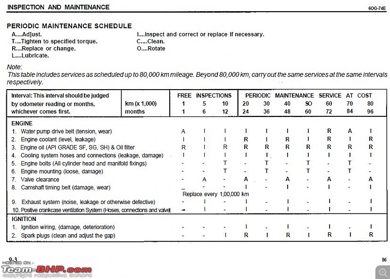

Originally Posted by aaggoswami
However, our Baleno got regular mineral oil and service interval is 5K kms.
OT here, but since you mentioned - how do you say service interval is 5K kms for Baleno ? It is 10K kms or 1-year for service & oil-change. If your MASS has been insisting on bringing it every 5K kms, then they have been fleecing you like the MASS here at Chennai. Check the relevant portion from the Baleno manual below which indicates the periodic-service duration and oil-change to be 10K kms or 12months
Review: 2nd-gen Maruti Swift (2011 - 2017)-balenomaint.jpg
But to the best of my knowledge, the K series have been moved to synthetic oil by Maruti ( i.e.Maruti recommends synthetic oil ).
Where do they recommend it? Is it there in your WagonR manual ? We don't see it in the A-Star manual as I mentioned earlier. And how did you make out that your Waggy came with synthetic oil?
EDIT: Checked the manuals of both OldWaggy and K10Waggy online on the MSIL site and no reference seen to synthetic. Also oil change interval is 10K kms for both. Only difference I see is in the recommended grade of oil. For oldWagonR, they have mentioned API Grade SF/SG/SH, while for the new one, they mention API Grade SG+. Does SG+ mean synthetic ?
