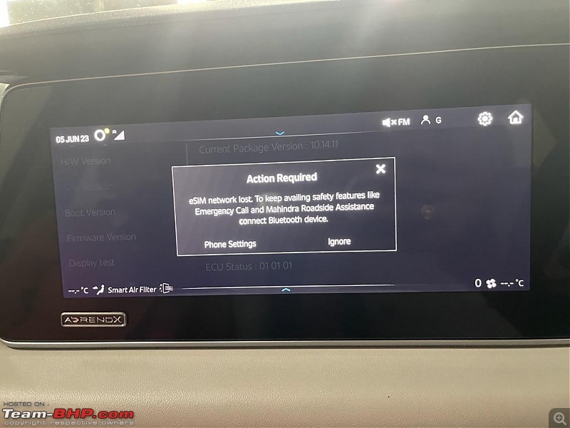

I got this screen on my AWD AX7L. Since then I lost connectivity with the Adrenox App. Possibily the eSIM connection is lost. I checked on the Subscription manager on the app and it is valid upto 23-04-2024. Should I take the car to the centre, which is 100KM away from my place or is there way to fix this at home. I already tried connecting the mobile with bluetooth and with cable but does'nt work.
Disconnect the battery for 5 mins and connect it back. I faced the network lost issue once and that fixed it.
