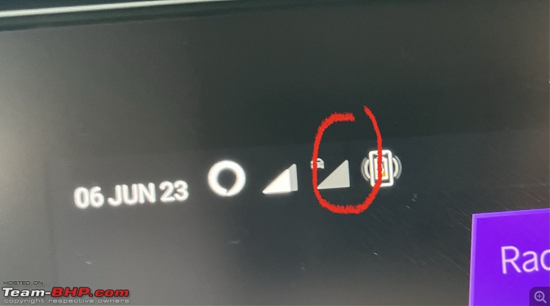

Originally Posted by avijayr View Post
My XUV7OO MT AX7 is from Feb 2022. I had setup Adrenox to notify me for all the options (like > 5 min idling, driving too fast, engine start/stop, etc). This worked for a few weeks, but a few months ago it stopped notifying me. Has anyone else faced a similar issue? When I login into my Adrenox on my Android phone, I can see that all the options are still ticked, but I dont get any notifications. I had thought it might have been due to an Android Auto update from a couple of months ago - but I don't remember when it stopped working.
Can anyone please give any pointers?
I think it could be because your e-sim has stopped connecting to the mobile network. See if the network indicator is showing signal availability. Most probably, your signal indicator may be showing zero signal strength (something like the attached screenshot)
If e-sim has stopped connecting to mobile network, then you could:
  1. Check if the vehicle has gone into Service Mode in the vehicle settings in the vehicle onboard Adrenox settings. If it has, toggle it to Off position. See if you are able to connect to your vehicle with your Adrenox Connect app now.
  2. (This is something that worked for me) If Service Mode was already Off, try toggling it to On position and drive your vehicle for a few hours or days with the toggle at On position until the network signal indicator starts to show some signal strength. Once you get back the network signal, switch back to Service Mode= Off position. At this point, Adrenox Connect mobile app should connect to your vehicle and start sending you the notifications.
  3. If none of the above works, disconnect the negative terminal of your car battery and reconnect after 5 minutes as some posts in this forum have suggested. However, if you are not very confident working on the guts of your vehicle, the better option would be to make a quick visit to your nearest service center.
